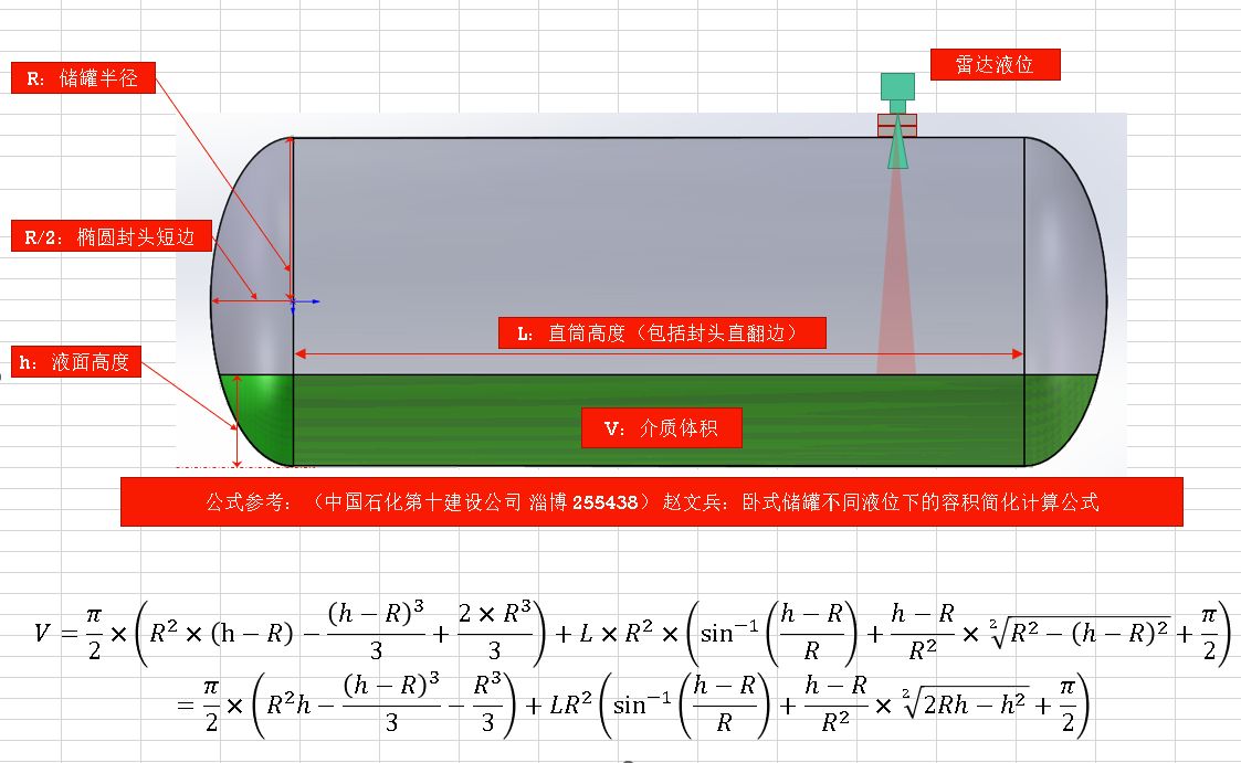

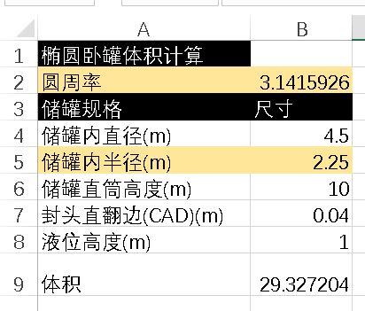

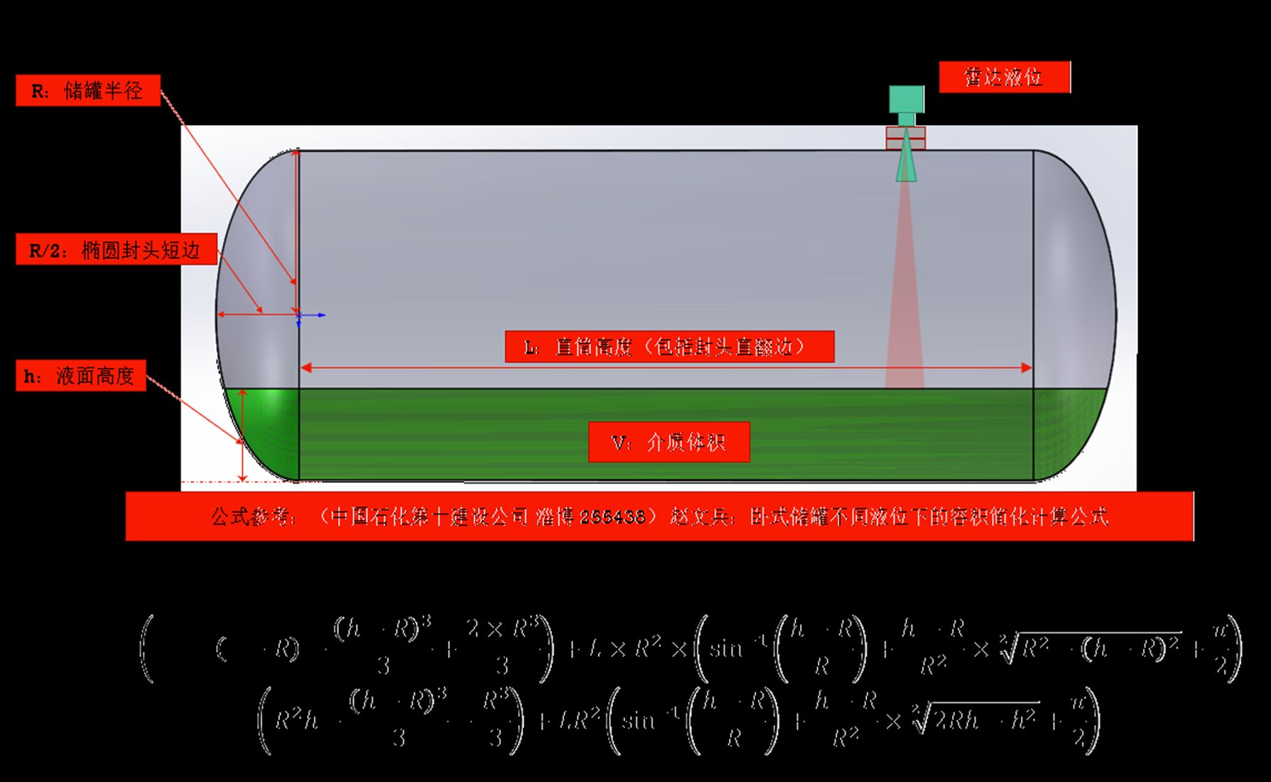

椭圆储罐-卧式储罐体积计算
207 |0
【本群组:自控仪表圈
卧式储罐体积计算
=B2/2*(B5^2*(B8-B5)-(B8-B5)^3/3+(2*B5^3)/3)+B6*B5^2*(ASIN((B8-B5)/B5)+(B8-B5)/B5^2 *(B5^2-(B8-B5)^2 )^0.5+B2/2)
