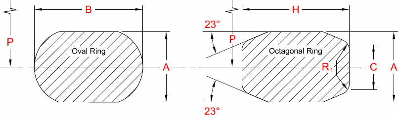

防止8角垫片泄露的措施有哪些?谢谢。
发表于 2014-4-25 10:13:02
学者VIP会员 VIP会员 | 显示全部楼层       最后访问IP江苏省
金属垫片的尺寸公差控制在+/-0.15mm
直径谨防椭圆,
密封面角度公差要控制在0.5度,
General notes:
All dimensions are in millimeters.
Tolerances:
  • P = average pitch diameter of ring ±0.18
  • A = width of ring ±0.20
  • B & H = height of ring +1.3. -0.5
    Variation in height throughout the entire circumference
    of any given ring shall not exceed 0.5 within these tolerances
  • C = width of flat on octagonal ring ±0.20
  • R1 = radius in ring ±0.5
  • 23 deg = angle ±0 deg 30 min
  • R-30 = for lapped joint only

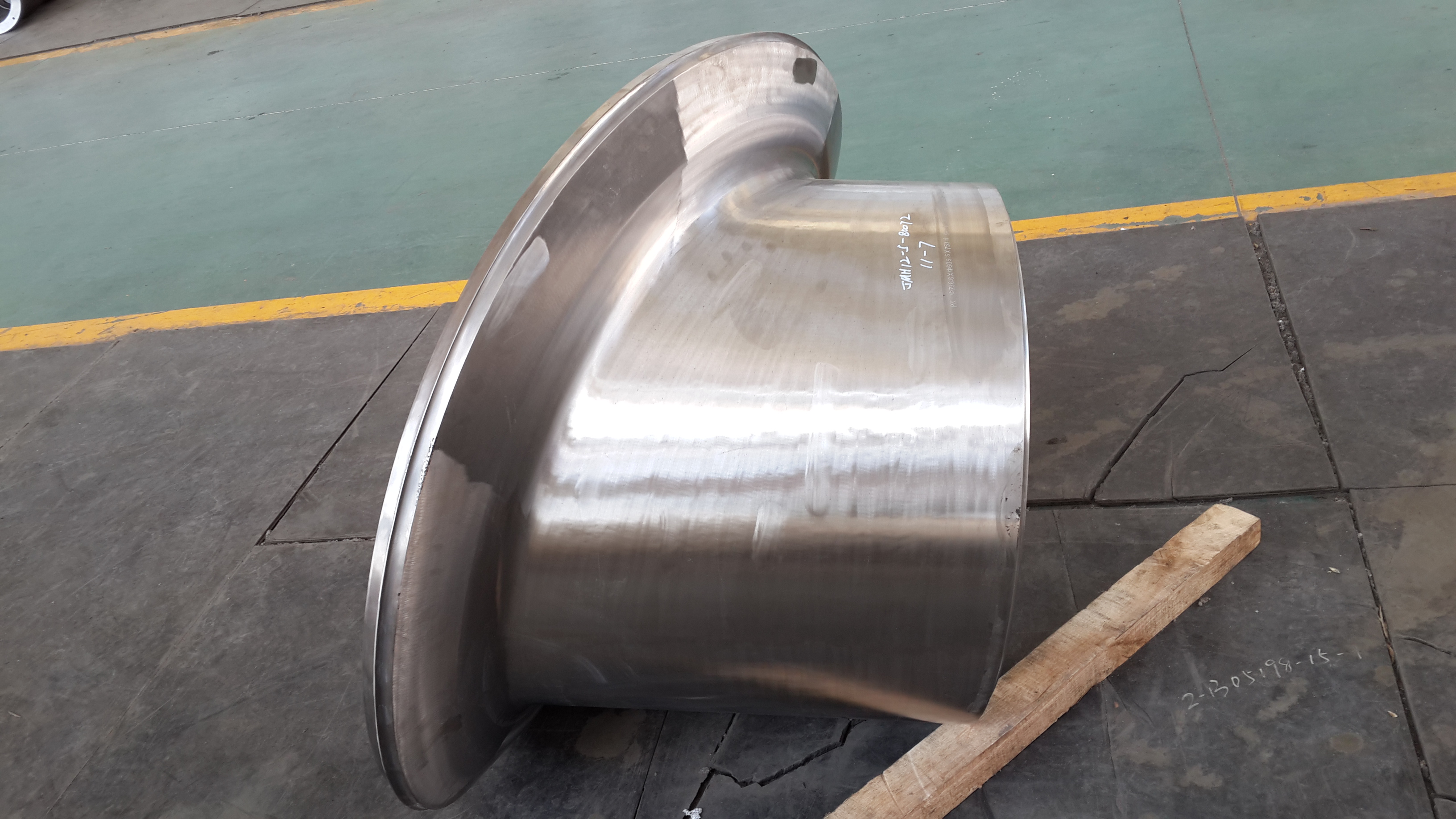

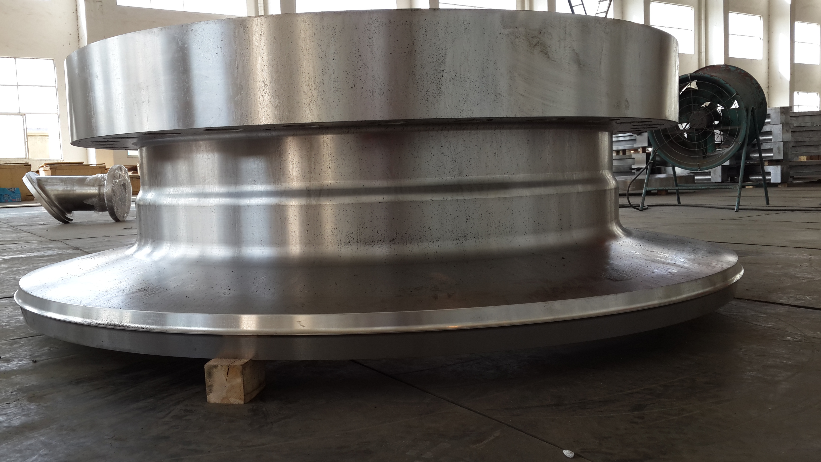

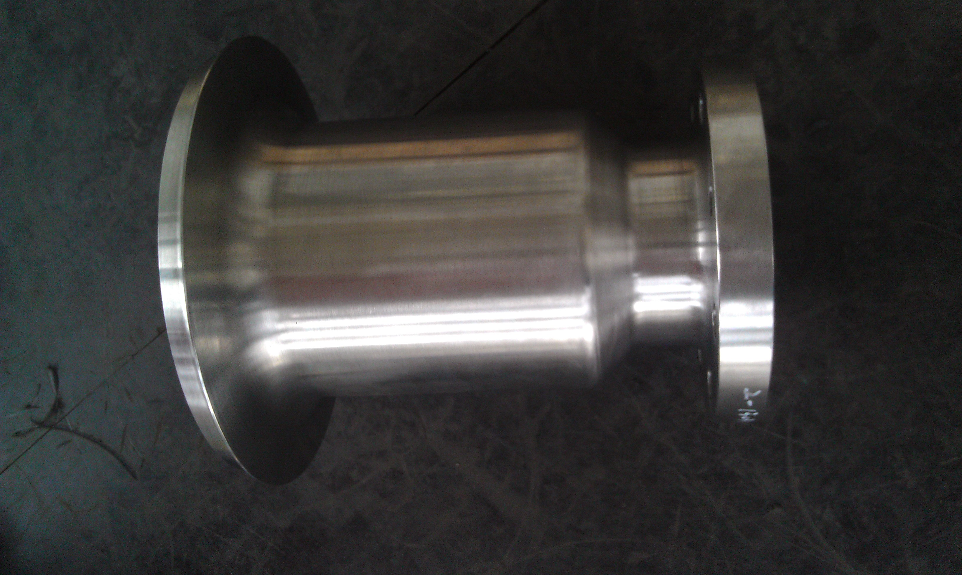

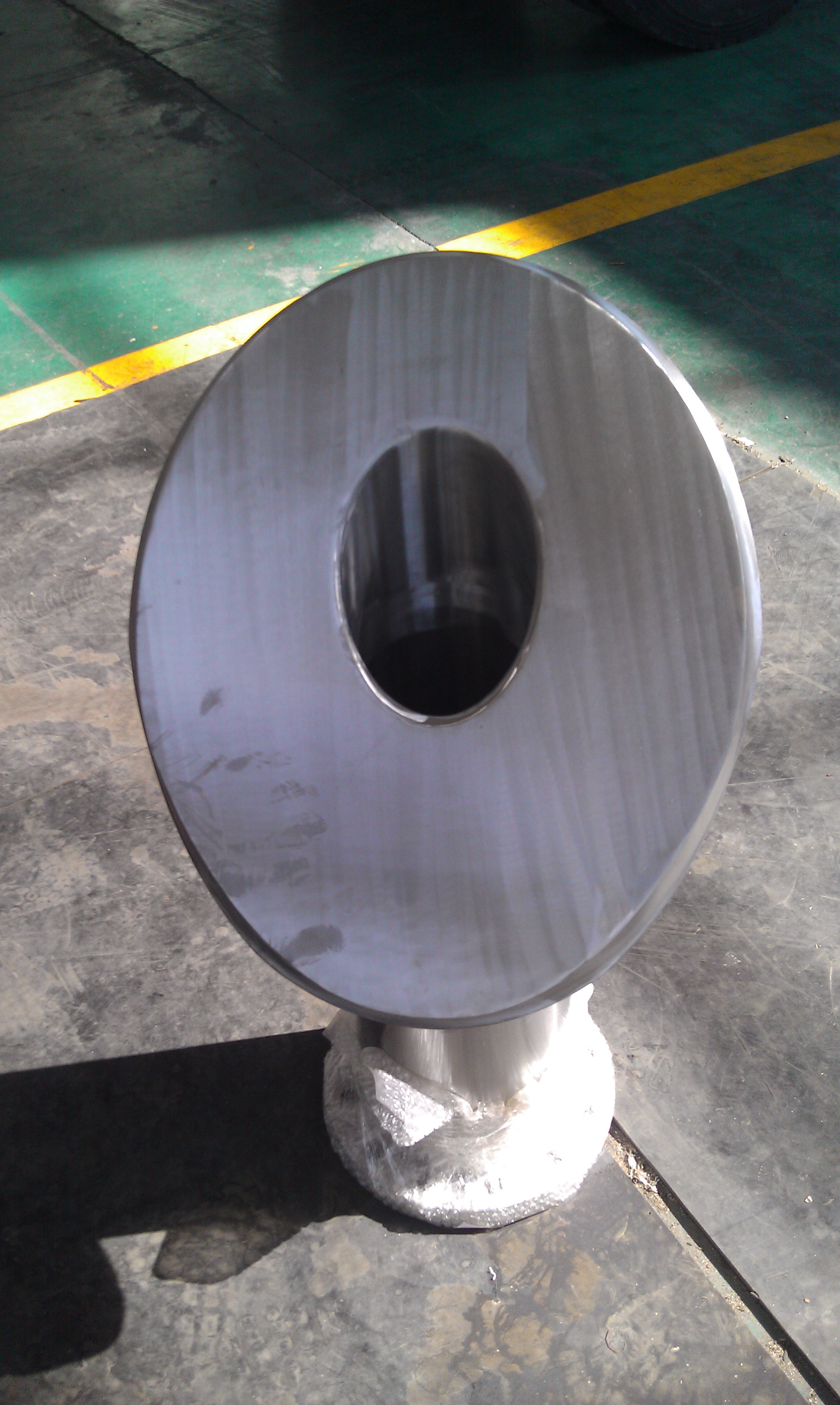

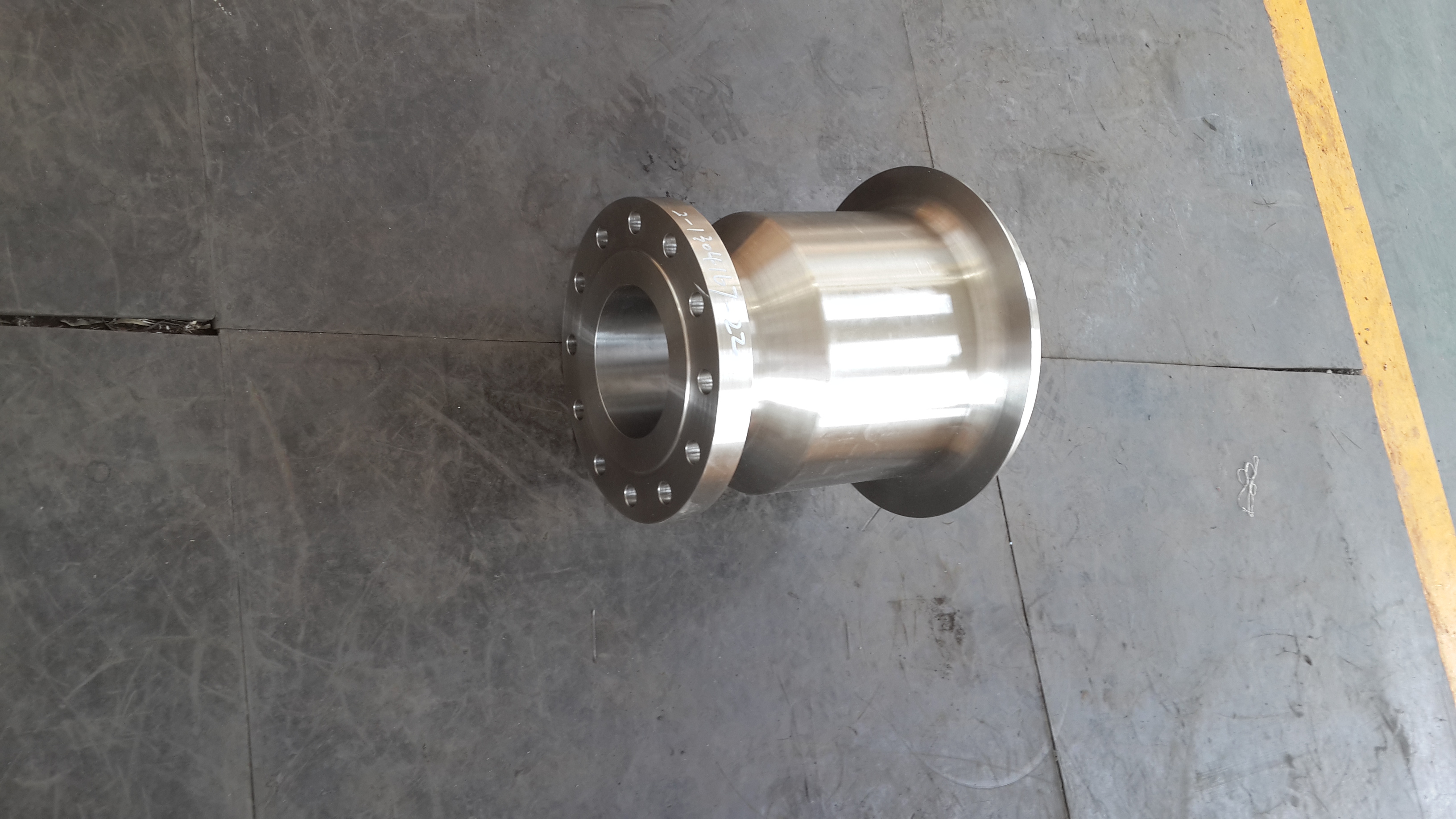

法兰系列图片
发表于 2014-4-25 12:33:28
