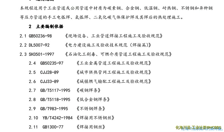

热处理的方法和步骤:依据GB50184 GB50236 GB50517
