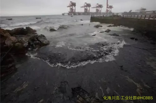

[attachimg]1492052[/attachimg] [attachimg]1492053[/attachimg]  详情 回复 发表于 2018-11-10 20:50
