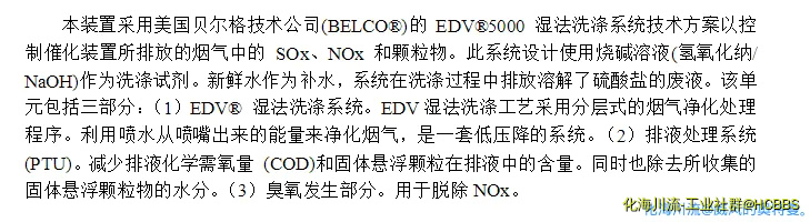

[attachimg]2935110[/attachimg]  详情 回复 发表于 2021-12-5 17:47

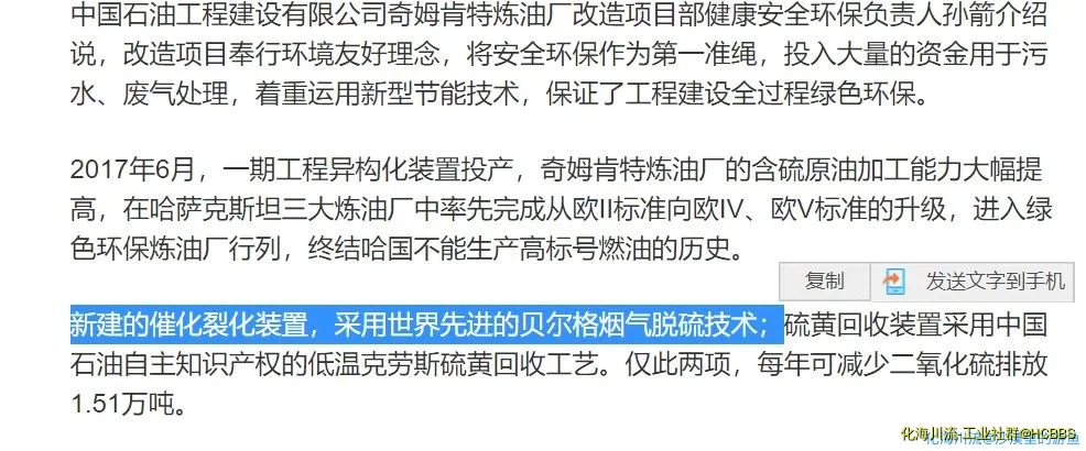

[attachimg]2935114[/attachimg]  详情 回复 发表于 2021-12-5 19:42
