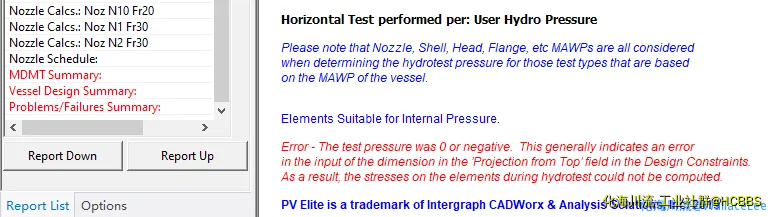

如图所示:在PVElite导出的计算书中,在内压设计计算部分,出现了以下关于测试压力的错误:
Error - The test pressure was 0 or negative.  This generally indicates an error in the input of the dimension in the 'Projection from Top' field in the Design Constraints. As a result, the stresses on the elements during hydrotest could not be computed.
错误-测试压力为0或负值。 这通常表示在“设计约束”的“从顶部投影”字段中的尺寸输入错误。因此,无法计算水压试验期间元件上的应力。
关于这个错误我非常不解,水压试验为什么会和“Projection from Top”有关系呢,当我对“Projection from Top”点击F1进行求助时,得到的解释也让我一头雾水:
而当我输入各接管的伸出长度150mm时,依然显示测试压力错误。
求助问题:
1.PVElite中,设计约束中的“Projection from Top”具体指的是什么?和水压试验有什么关系?
2.RT,测试压力出现错误这个问题如何解决?

发表于 2020-7-22 09:02:54
输入接管长度的地方去掉数据即可

PVELite error waring is a general info that may not point directly where or what is wrong.
You should input 'UG-99b' (or others options) in' Hydrotest Type' rather than 'User Entered Pressure' so that PVELite will know how to calculate the hydrotest pressure. Or another way, you have to input the MAWP for both shell side and tube side in tubesheet input dialog if Hydrotest Type is 'User Entered Pressure'. Mostly sure that will settle your issue.
As you know the software translation may not be so good. So, do not understand that may be better than misunderstanding to act.
