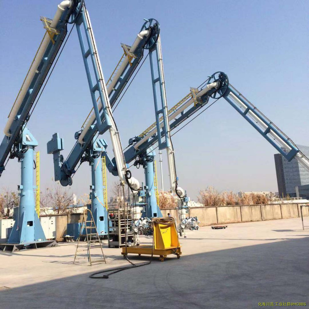

Marine Loading Arms made in China
发表于 2020-1-10 21:11:04
Marine Loading Arm
Marine Loading Arm
