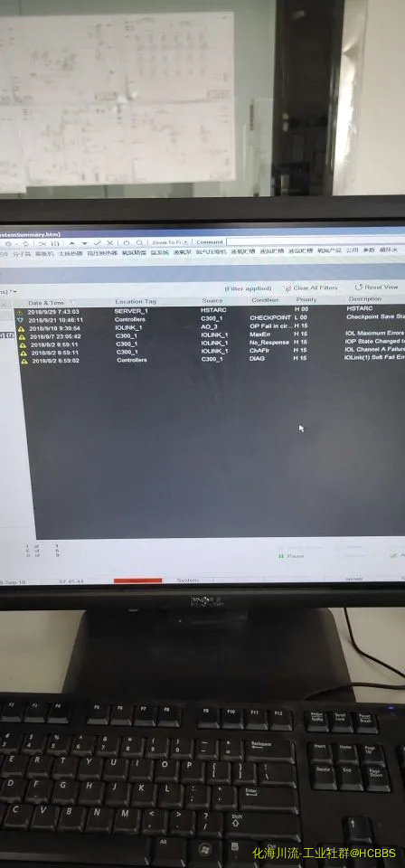

[讨论] 霍尼韦尔系统报警显示求指导
4K |8
沫沫小白VIP会员 VIP会员 | 显示全部楼层 |阅读模式       最后访问IP江苏省
请说下都什么问题,第一个服务器,求大神指导
发表于 2018-9-29 11:01:17
955559 + 5 发起议题
当前内容由会员用户名 沫沫小白 发布!权益归其或其声明的所有人所有 仅代表其个人观点, 仅供个人学习、研究之用。
zzllypVIP会员 VIP会员 | 显示全部楼层       最后访问IP新疆维吾尔自治区
图片这么不清楚,而且截屏又不全,怎么帮?第一个勉强帮一下
HSTARC system alarms
第四个
IOL Maximum Errors Exceeded
Applies to IOLINK.
Potential causes
The number of IOL Communication and Silence Errors exceeds the MAX limit.
Consequence of inaction
Loss of communication with IOPs.
Corrective actions
Channel A and Channel B errors need to be addressed.
第二个
DIAG - Checkpoint Save Status
Potential causes
An error has occurred when saving a Checkpoint. Additional information about the specific error can include:
• Failed/abnormal completion; state of the last checkpoint save for that node. This is indicated by one of the
following values in the Checkpoint Status (CPSTATUS):
– Complete With Stale Data
– Complete With Dangling Data
– Complete With Mismatched Data
– Failed – Other, see server err logs
• RTN - Successful completion; state of the last checkpoint save for that node. This will be indicated by the
value “Complete” in CPSTATUS.
Inability to migrate.
Corrective actions
See the following topics in the “Appendix F - Control Builder Checkpoint Reference” section of the Control
Building User's Guide.
• “Checkpoint file attributes”
• “Checkpoint Alarming”
• “Fixing Common Problems”
Time to respond
Next Checkpoint sav

沫沫小白楼主 VIP会员 VIP会员 | 显示全部楼层       最后访问IP江苏省
zzllyp 发表于 2018-09-29 15:07
图片这么不清楚,而且截屏又不全,怎么帮?第一个勉强帮一下<b
谢谢大神,等我找个全的
发表于 2018-9-29 17:43:40
沫沫小白 发表于 2018-09-29 17:43
谢谢大神,等我找个全的
能说下,是什么具体原因吗,怎么处理
发表于 2018-9-29 21:38:19
Potential causes 和 Corrective actions 是什么意思呢?
发表于 2018-9-30 03:31:31
\u6f5c\u5728\u95ee\u9898\u3002  \u7b2c\u4e8c\u4e2a\u662f\u8c03\u6574\u5427
发表于 2018-9-30 07:02:16
\u662f\u4ea4\u6362\u673a\u7684\u4e8b\uff0c\u8fd8\u662f\u9632\u706b\u5899\u7684\u4e8b\u5462
