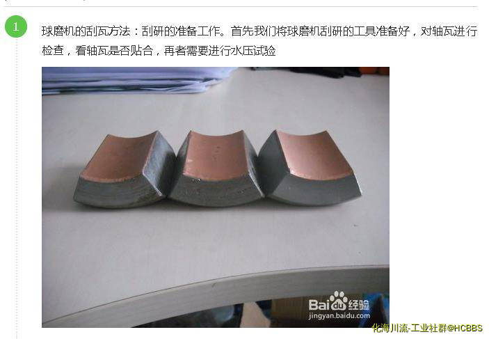

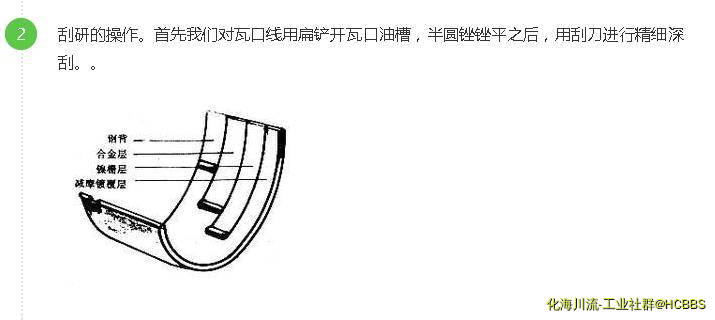

[attachimg]1956770[/attachimg]  详情 回复 发表于 2019-7-19 11:18
