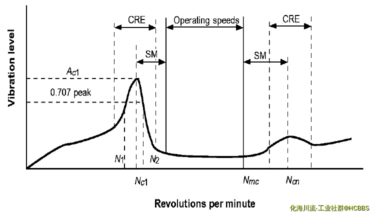

临界转速是什么    离心式二级压缩机能不能长期在一级临界转速下运行?

在 API 617 - 2002 (7th)第 1.5.4 条中,对临界转速(Critical Speed)的定义如下:
  - 当转子、轴承及其支承系统处于共振状态下的转速。
  - A shaft rotational speed at which the rotor-bearing-support system is in a state of resonance.
如图,离心式压缩机通常运转在一阶临界转速和二阶临街转速之间
根据API 617 - 2002 (7th)第 2.6.1.3 条规定:
在你购买压缩机的时候,共振结构支持系统应含在供应商的供货范围之内。供应商所提供的设备,在指定的操作速度范围及其安全余量(SM:Separation Margins)内,不应出现影响转子振动幅度的因素。转子动平衡分析,应当把转子、轴承及其支承系统有效刚度考虑在内(见2.6.2.4d)。
Resonances of structural support systems that are within the vendor's scope of supply and that affect the rotor vibration amplitude shall not occur within the specified operating speed range or the specified separation margins (SM) (see 2.6.2.10). The effective stiffness of the structural support shall be considered in the analysis of the dynamics of the rotor-bearing-support system (see 2.6.2.4d).
在该标准的的第 2.6.2.10 条中,对该安全余量(Separation Margins)做出了详细的规定:
机组的阻尼不平衡响应分析,应满足以下三条对于安全余量(SM : Separation Margins)的要求:
The damped unbalanced response analysis shall indicate that the machine will meet the following SM:
a. 如果在一具体临界转速上的(放大系数)AF < 2.5,则该响应被看作是临界阻尼,并且对其安全余量(SM)不作要求。
a. If the AF at a particular critical speed is less than 2.5, the response is considered critically damped and no SM is required.
b. 如果在一具体临界转速上的(放大系数)AF ≥ 2.5,并且该临界转速低于机组的最低转速时,该安全余量(SM:作为最小转速的百分数)应不小于 SM=17(1-1/(AF-1.5)) 或值16,两者中的较小者。
b. If the AF at a particular critical speed is 2.5 or greater and that critical speed is below the minimum speed, the SM (as a percentage of the minimum speed) shall not be less than the value SM=17(1-1/(AF-1.5)) or the value 16 which ever is less.
注:换句话说,当临界转速小于机组最低转速时,距离一阶临界转速的安全余量SM≤0.16·Nmin(最小连续转速)。16%·Nmin是该情况下的余量最大值。
c. 如果在一具体临界转速上的(放大系数)AF ≥ 2.5,并且该临界转速高于最大连续转速,该安全余量(SM:作为最小转速的百分数)应不小于SM=10+17(1-1/(AF-1.5))或值26,两者中的较小者。
c. If the AF at a particular critical speed is equal to 2.5 or greater and that critical speed is above the maximum continuous
speed, the SM (as a percentage of the maximum continuous speed) shall not be less than the value SM=10+17(1-1/(AF-1.5)) or the value of 26 which ever is less.
注:换句话说,当临界转速大于机组最大连续转速时,距离二阶临界转速的安全余量SM≤0.26·Nmax(最大连续转速)。26%·Nmax是该情况下的余量最大值。
综上所述,机器是不允许运行在一阶临界转速及其安全余量的范围之内的。
