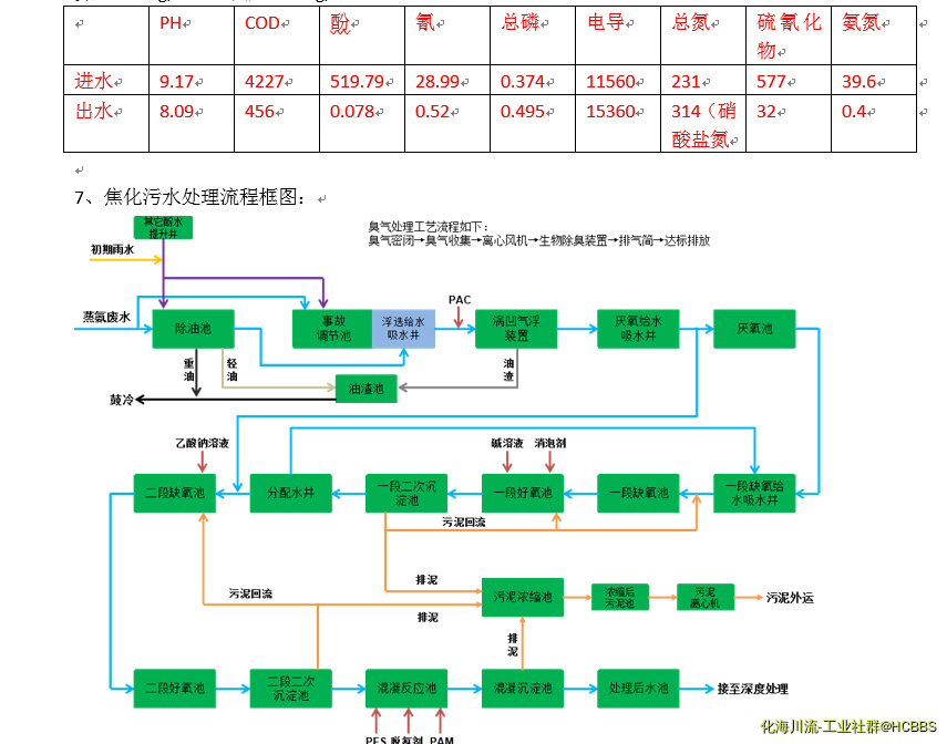

[求助] 焦化废水处理请各位大神分析一下原因
11.4K |4
flspscVIP会员 VIP会员 | 显示全部楼层 |阅读模式       最后访问IP上海市
1、各类废水进水水量:蒸氨废水90m3/h
3、各类废水进水水质:pH9.17,氨氮:39.6mg/L,COD:4227mg/L,酚:519.79mg/L,氰:28.99mg/L,电导:11.56mS/cm,总磷:0.374mg/L,硫氰化物577mg/L,总氮:231mg/L
4、平均总进水量:90 m3/h
5、平均总进水水质:pH9.17,氨氮:39.6mg/L,COD:4227mg/L,酚:519.79mg/L,氰:28.99mg/L,电导:11.56mS/cm,总磷:0.374mg/L,硫氰化物577mg/L,总氮:231mg/L
6、二沉池出水水质:pH:8.09,氨氮:0.4mg/L,COD:456mg/L,酚:0.078mg/L,氰:0.52mg/L,电导:15.36mS/cm总磷:0.495mg/L,硫氰化物32mg/L,硝态氮:314mg/L,亚硝态氮:174mg/L,总氮:120mg/L,悬浮物:50mg/L 101248kzjbm5n5i5ib4ltb.png
