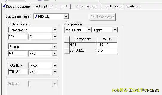

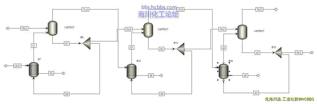

    在《化工计算与软件应用》x i题3-4中,丙烯腈废水三效蒸发,刚开始就出现报错,是因为版本不同的原因么?
Processing input specifications ...
  *   WARNING IN PHYSICAL PROPERTY SYSTEM
      UNIFAC GROUP STRUCTURAL INFORMATION PARAMETER, UFGRP , MISSING FOR
      ALL COMPONENTS; NO UFGRP PARAMETERS SUPPLIED BY USER;
      DEFAULTS NOT FOUND IN DATA BANK
      MW MISSING FOR COMPONENT C6H8N2O
  **  ERROR IN THE "STREAM" PARAGRAPH WHICH BEGINS ON LINE 60
      STREAM NAME: 70-2
      MOLECULAR WEIGHT MISSING FOR COMPONENT: "C6H8N2O".
      STREAM FLOW NOT CALCULATED.
  *   WARNING WHILE CHECKING INPUT SPECIFICATIONS
      INCONSISTENT PROPERTIES DETECTED FOR STREAM "71-2"
      FROM BLOCK: "1-EFFECT"  PROPERTIES: UNIFAC
        TO BLOCK: "B12"  PROPERTIES: STEAM-TA
      INCONSISTENT PROPERTIES DETECTED FOR STREAM "73-2"
      FROM BLOCK: "2-EFFECT"  PROPERTIES: UNIFAC
        TO BLOCK: "B16"  PROPERTIES: STEAM-TA
! Errors while processing input specifications
