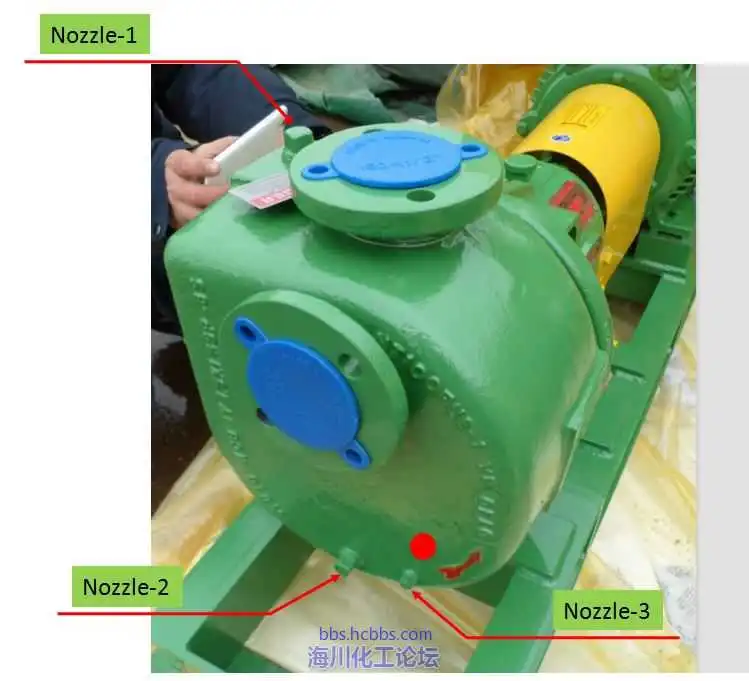

各位海友,请问附图的自吸泵的3个开孔嘴子的作用是什么啊?关于“Nozzle-3”,厂家资料的描述是“It is recommended to install a pipe connecting the casing NOZZLE-3 to the seal chamber or gland.
The purpose of this line is to keep the seal faces wet during the priming cycle.”
厂家给答复了,原文如下“Nozzle 1 should be filled with water before pump start.
Only water is injected first and then plugged.
The nozzle 2 is for casing drain. When the pump is repaired, it serves to empty the water in the casing.
Nozzle 3 is a mechanical auxiliary plan. You can plug it.

1:灌液孔
2:放液孔
3:不知道

猜猜3是压力测点预留口

不是,请参考"It is recommended to install a pipe connecting the casing NOZZLE-3 to the seal chamber or gland.
The purpose of this line is to keep the seal faces wet during the priming cycle"

轴封冷却用的啊

看英文意思是密封室冷却用。
发表于 2017-4-20 11:06:23
1:灌液孔
2:进口腔放液孔
3:出口腔放液孔

见过的自吸泵,就只有灌液和排液螺塞~~就是上图的1、2~~3就不知道了~~问问厂家吧~~

1:灌液孔 2:放液孔 3:也是放液孔。

一是灌液的,二是放空的,三应该是顶丝。
