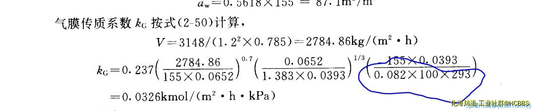

现代填料塔技术指南 王树楹,主编,例题里面水吸收SO2 计算,P248页,对下图云线部分没看懂,不应该是8.314*T,为啥是0.082*100*T,此处没看懂,请哪位帮忙解释一下,谢谢

单位的原因
Look at the units for the ideal gas constant. R = 0.082 has units of (L atm)/(mol K), whereas R = 8.314 has units of J / (mol K). If the question has pressure and volume expressed in units of atm and liters respectively, you use the R = 0.082 value. If the pressure is expressed in pascals and volume in cubic meters, you use R = 8.314 value (same if pressure is expressed in kilopascals and volume in liters, because 1 kPa = 1000 Pa and 1 L = 1/1000 m^3).
The two R values are the same thing but the reason for the differences is due to having different units. R = 8.314 is actually the more important value because it is expressed in SI units (note that 1 J = 1 Pa * m^3= 1 N/m^2 * m^3 = 1 N * m).

R=PV/T=22.4/273.15=0.082
谢谢,一提醒,就能理解。
