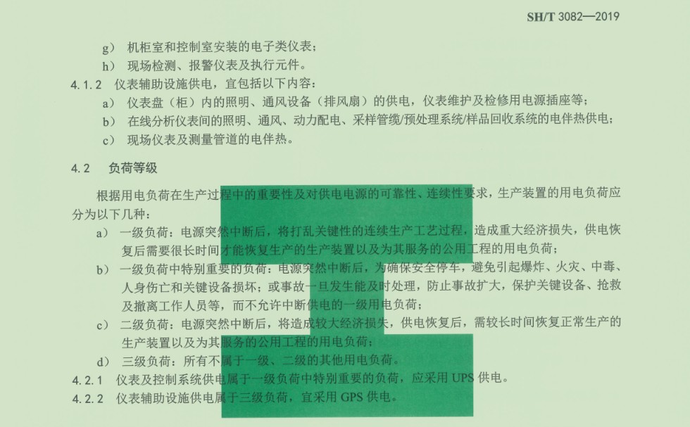

请教各位大神,仪表控制系统需要用UPS电源,出自哪个国际规范?国际项目,谢谢!

选择遗忘2010VIP会员 VIP会员 | 显示全部楼层       最后访问IP山东省
规范是最好的说明,自己动手丰衣足食
发表于 2021-4-1 09:50:35
SH-T3082-2019石油化工仪表供电设计规范.pdf
27.04 MB, 下载次数: 1, 下载积分:财富 -10 财富值
另需要【30  财富值】  [记录]  [预览]
HG_T20509-2014 仪表供电设计规范.pdf
963.88 KB, 下载次数: 1, 下载积分:财富 -10 财富值
这个描述太泛了。应该是根据行业或控制要求的性质才看相应有没有规定,比如化工行业,或是用的是SIS之类的。 要是最普通的控制系统并不是一定强制要求要有UPS的,但意外失电明显会对硬件造成可能的故障,数据丢失之类,这个风险就需要评估能不能承受了。也有一些品牌的DCS等本身会有必须或推荐的供电要求,可以参见下厂家系统说明。

loonfan楼主 VIP会员 VIP会员 | 显示全部楼层       最后访问IP北京市
myface 发表于 2021-4-1 10:28
这个描述太泛了。应该是根据行业或控制要求的性质才看相应有没有规定,比如化工行业,或是用的是SIS之类的 ...
谢谢!
我这个是油气输送行业的控制系统,国内的规范确实有明确规定的2楼大神也提到了。
目前在API 554找到一点相关的规定
API554
11.3.1 Power Source
The primary power source for all process control systems is supplied from a public utility or internal plant generation
system. Does the primary power source meet the availability and reliability requirements for the process control
systems? If not, additional design considerations should be evaluated.
Some examples to increase availability and reliability of the primary power source are:
— double-ended electrical substations;
— emergency generators;
— static transfer switches between two power sources; and
— UPS.
The process control system power source generally must have high availability and reliability, because it powers the operators interface to the process. This would include the DCS, PLCs, analyzers, alarm systems, field instrumentation, information systems, interface to motor controls and other systems. These systems should be powered from a UPS system that can provide back up power for a minimum of 30 minutes. Care must be taken in the design of the power source to the DCS to avoid a single point of failure causing loss of control.
发表于 2021-4-1 15:30:57
不错啊,有参考价值。国内的好定义是因为有用电负荷的分级规定,但似乎没看到国外有相应的分级标准。  详情 回复 发表于 2021-4-1 16:31
loonfan 发表于 2021-4-1 15:30
谢谢!
目前在API 554 ...
发表于 2021-4-1 16:31:01
