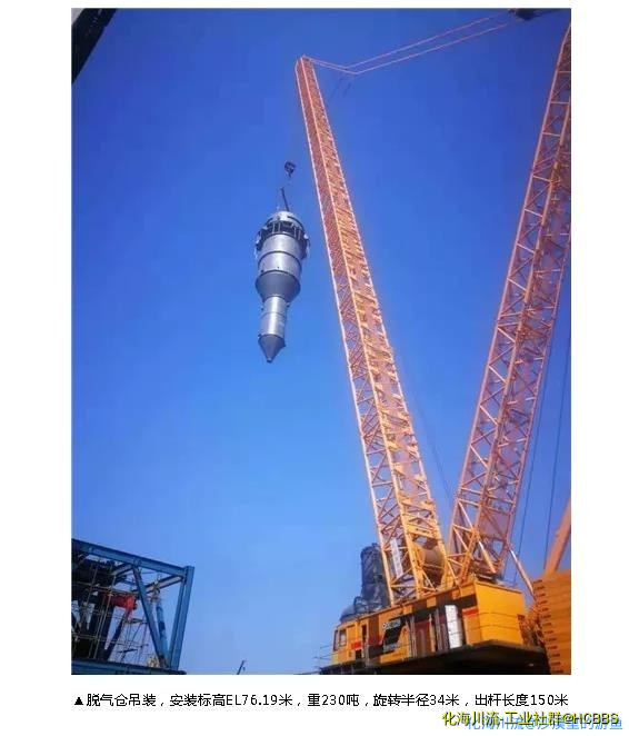

来自网络上的消息,很值得参考。这里截图给大家分享讨论 ============================================= [attachimg]2570937[/attachimg]  详情 回复 发表于 2020-8-21 21:43

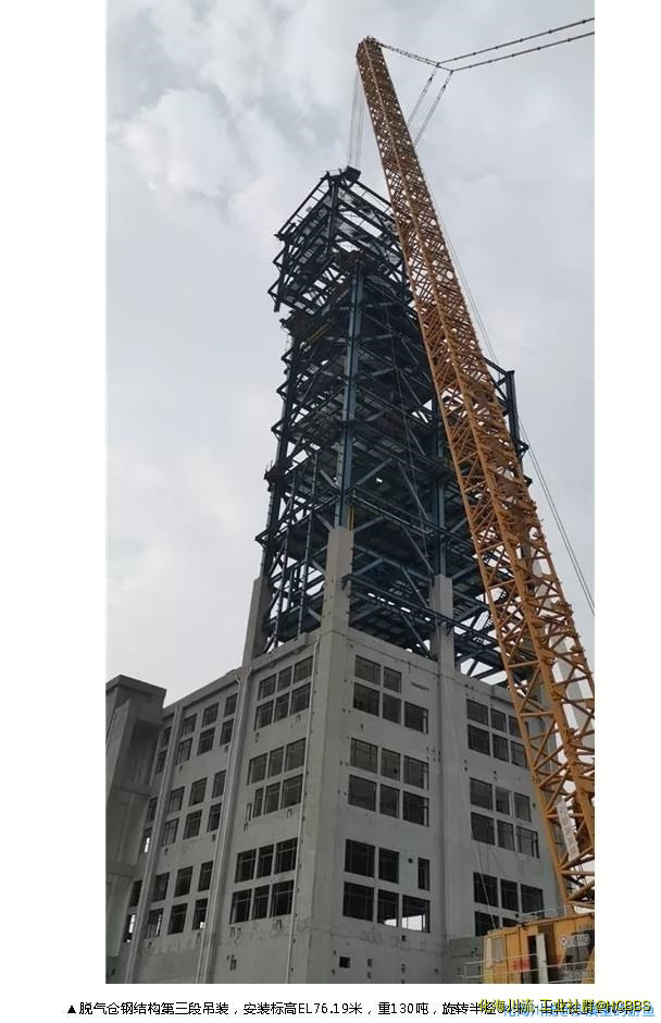

[attachimg]2572275[/attachimg]  详情 回复 发表于 2020-8-22 19:32
[attachimg]2571986[/attachimg]  详情 回复 发表于 2020-8-22 14:32

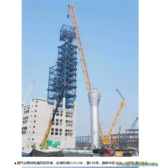

[attachimg]2573066[/attachimg]  详情 回复 发表于 2020-8-23 17:55
