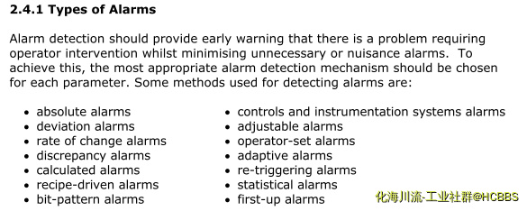

1、控制和仪表系统警报(简称系统报警):由控制和仪表系统硬件或软件故障产生的报警。这些信息非常有用,但应注意,它们与操作员相关,应易于操作员理解。这些报警通常被误用。注意,最好能够将这些系统警报的显示与工艺过程警报分开。Control and instrumentation system alarms:  generated from faults within the control and instrumentation system hardware or software.  These can be useful, but care should be taken that they are relevant to the operator and easily understood by the operator.  These are commonly misused.  Note that it may be desirable to be able to separate the display of these system alarms from the process alarms.
2、工艺过程报警(process alarms):与工艺过程参数和操作有关的报警,EEMUA191进一步进行了细分:绝对报警、偏差报警、变化率报警、计算的报警、不一致报警、首出报警等等。
3、再说一下报警的重要性,在保护层(LOPA)里,报警和人为干预位于保护层的第三层,如果报警提醒后操作员及时处理,工艺过程就回归到正常生产状态,忽略了报警或没有控制好就会导致联锁的发生。所以,要进行报警分级,防止报警过多导致报警泛滥,要去除无效报警,减少操作人员负荷,同时可根据报警的等级优先处理。有的控制系统配置了先进报警管理系统(AAS)就是评估报警系统的有效性并给出优化建议。如下是关于报警管理的规范:
IEC 62682-2014 Management of alarms systems for the process industries
ANSI-ISA-18.2-2016 Management of Alarm Systems for the Process Industries
EEMUA 191 alarm systems - a guide to design, management and procurement
