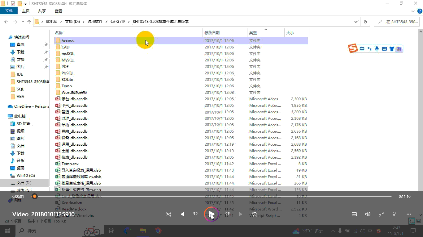

SH/T 3543-2017和SH/T 3503-2017批量生成工具
链接地址:https://bbs.hcbbs.com/forum.php?mod=viewthread&tid=3596908&mobile=2
