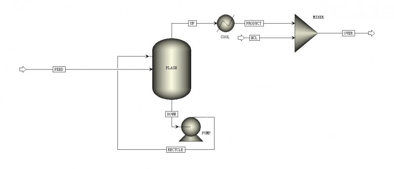

有没有大神帮忙看一下呀,怎么收敛不了*  WARNING
   STREAMS CROSSING THE LOOP CONVERGED BY $OLVER01 ARE NOT IN MASS BALANCE:
   MASS INLET FLOW = 0.94270138E-04, MASS OUTLET FLOW = 0.16436167E-04
   RELATIVE DIFFERENCE = 0.47355305E+01
   IMBALANCE MAY BE DUE TO A LARGE RECYCLE FLOW, AND A
   RELATIVELY LOOSE TEAR STREAM TOLERANCE.

没液相出料怎么可能平衡

流程本身就是错误的,死循环

只进不出的流程
