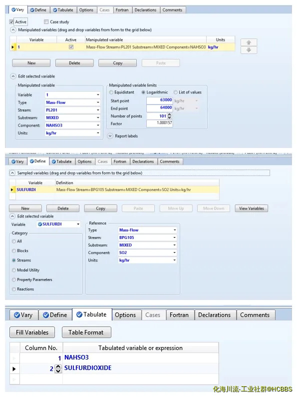

*** SEVERE ERROR
      ERROR COMPILING IN-LINE FORTRAN
      COMPILER MESSAGES FOLLOW ...
ASPCOMP: Warning!  Intel Fortran compiler ifort.exe not found in %PATH%
ASPCOMP: Warning! Microsoft C runtime library msvcrt.lib not found in %LIB%
ASPCOMP: Warning! Microsoft C runtime library is needed for Dynamic Linking.
ASPCOMP: Warning!  Intel Fortran runtime library libifcoremd.lib not found in %
ASPCOMP: Warning!  Intel Fortran runtime library is needed for Dynamic Linking.
ifort.exe file:///C:\Users\Dell\AppData\Local\Temp\OOY5$4OW5H`8`9%(9$)T67M.giflogo /c     -DAWINNTN -DWIN32 -I. "-IC:\Program Files (x86)\AspenT
'ifort.exe' 不是内部或外部命令,也不是可运行的程序
或批处理文肌?
或批处理文肌?
  *** SEVERE ERROR
      COULD NOT RESOLVE USER OR IN-LINE FORTRAN SUBROUTINE(S):
      SUBROUTINE "ZZSENS" IS MISSING
  *** SEVERE ERROR
       PROGRAM TERMINATED DUE TO UNRESOLVED ROUTINES
! Errors while processing input specifications
灵敏度分析
